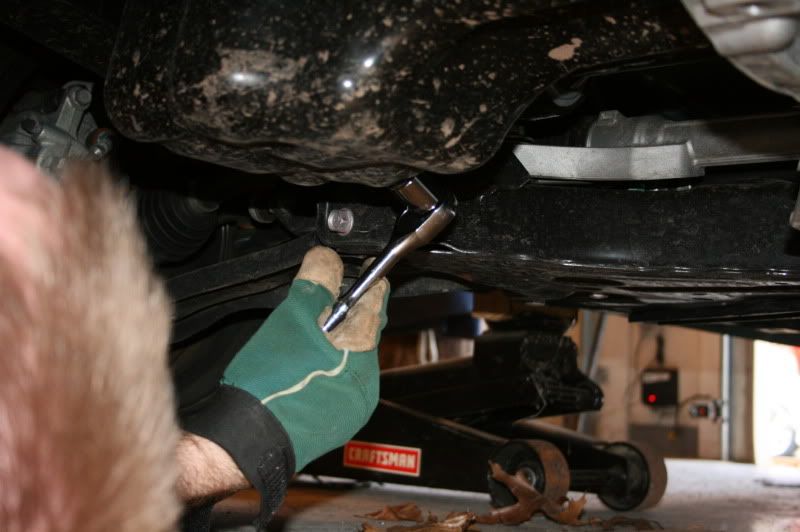

5) Slide under the car and use your 19mm socket to loosen and remove the drain bolt. I find it helps to break it loose first, then get the bucket ready and ratchet it out until I can spin it with my fingers. Caution: the used oil will come out fast at first, and may be hot. Also, be careful not to drop the drain bolt and washer into your oil bucket!

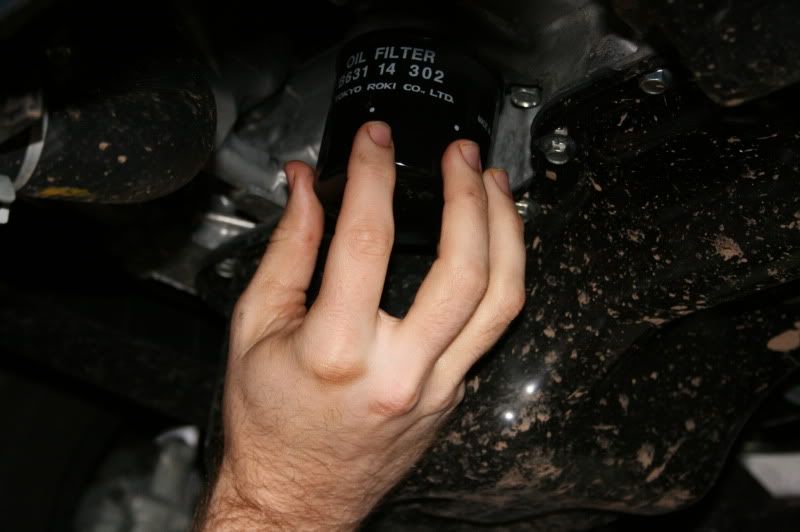

8) Use your Filter Pliers to break loose the spin off oil filter. As soon as you break it loose, put the oil pan underneath it and spin it off slowly. At some point the oil will start coming out. It spins pretty far though.
9) Get your new filter out and apply fresh oil to the rubber gasket. Pour some oil into the filter. If you fill the filter, you only put ~4.1 Quarts in later. It is a pain to put a full filter back on, so I usually half fill it and put in slightly more oil (4.2 Quarts. 4.4 is the recommended max)
10) Spin it in place and snug it tight. I hand tightened mine pretty far, no pliers required.
